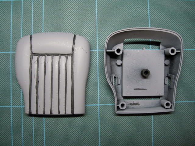

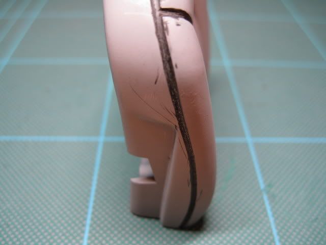

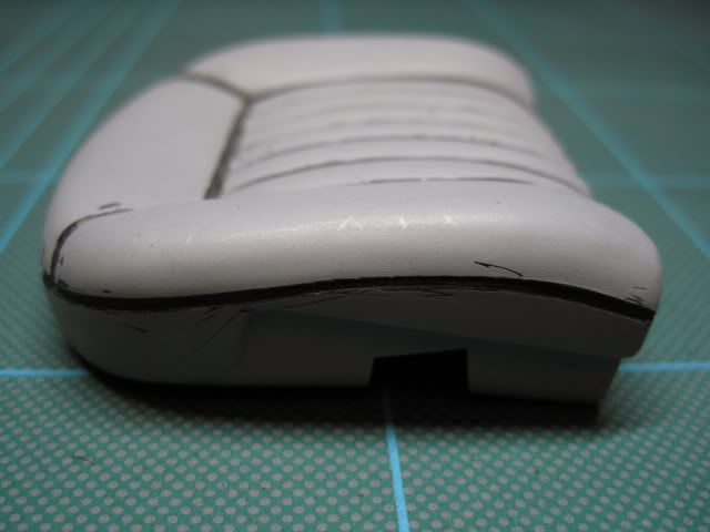

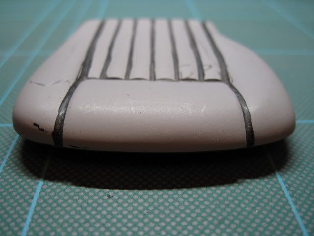

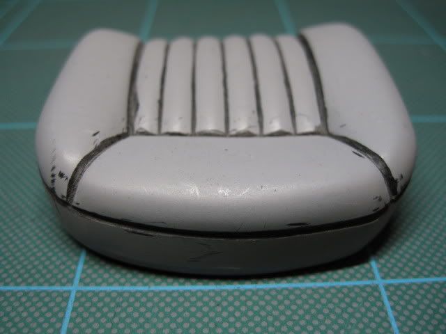

I'm starting on the seat now and have sprayed the parts grey so I can draw on my piping lines and cut a track for it to sit into.
I used Halfords Grey Plastic Primer and it goes on very easily. If I run into problems with the leather, I may just use this paint and then use Johnsons Klear to give a leather like sheen. In my opinion the sprayed finish looks just as good as the painted finish on the £1500 007 DB5 on a separate thread.
Now the fun really starts :?
Cheers - Tony

Method:

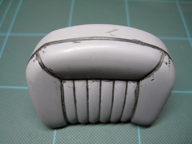

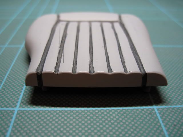

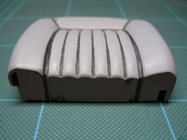

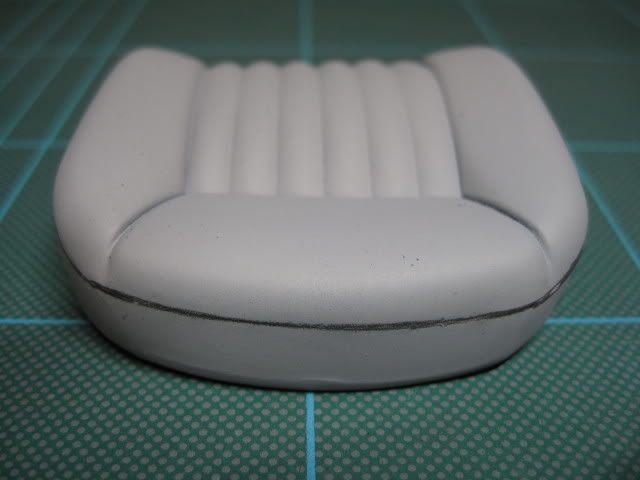

After priming the seats with Halfords grey plastic primer (spray can) I used a pencil to draw the line of the piping where there was no moulded line to go by.
I then used a small round file to file this track and also deepen the existing moulded lines including the ribbed seat cushion and back. The idea is to provide a channel for the piping to sit into and to deepen the seat cushion and back so you don’t lose the detail when you glue the leather on. It also provided a cutting line where the leather joins meet. I used a scalpel to trim the leather.

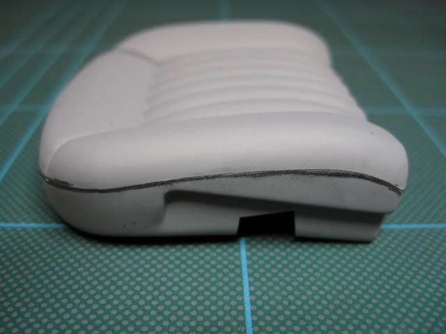

I filed a 45 degree chamfer on the seat mating face where it abuts the seat base to create a track for the piping to sit into.
I did the seat base first and started off by masking the bottom of the seat base so no glue got onto it. One piece of leather was used with a join in the middle of the back of the base.
I then masked around the seat cushion and glued the leather in place and then trimmed the excess off. This is when I made the mistake by masking over the leather I had already glued as mentioned earlier. I found it was okay to apply the glue with care without masking.
The other pieces were done this way.
I joined to two parts of the seat base together and piped along the tracks I had cut with a file earlier.
The seat backrest was done the same way and then assembled to the base.
The last job was to trim the back panel to fit inside the seat backrest and cover it with leather. Note that the seat back sits flush with the backrest but because the back panel has a leather covering, it’s necessary to trim the locator lugs inside the seat backrest to enable the back panel to sit inside the backrest.
There you have it, one leather seat.
I haven’t covered the centre console with leather yet or fitted seat adjuster because I will wait to see how I get on with doing the passenger seat and door cards. I have a spare driver’s seat and if the passenger seat goes wrong, I will buy another and just spray the seats, console and door cards grey.
I have learned a lot doing the seat so the passenger seat and rear bench should be easier but there are still lots of possible pitfalls along the way which is why I want a backup plan!
If you have read this to the end, well done!
