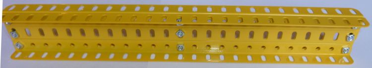

1) Build one of the four horizontal segments for the upper part of the crane tower:
Each segment is comprised of 2 flat girders (a) and 4 angle girders (b):

It builds another horizontal segment, identical to the previous one (issue 11)

Note that the distance between 2 holes in the Meccano parts is 0.5". For instance, the parts used in issues 11-13 are 25 holes long, i. e. 12.5" (about 32 cm)
