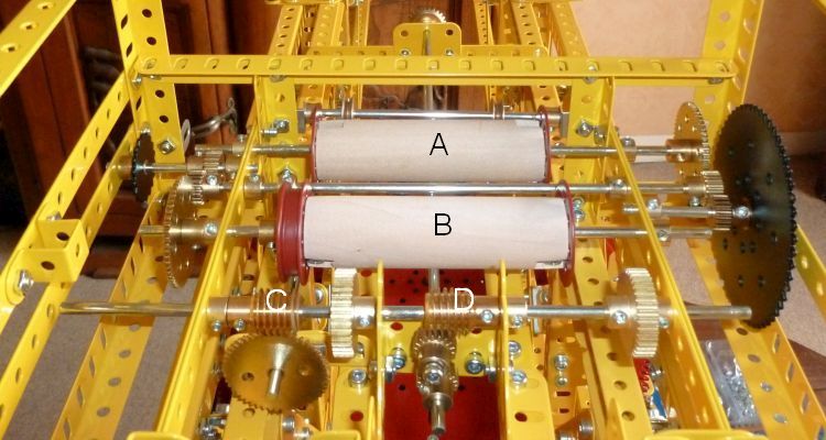

Postby jdebord » Sun Mar 07, 2021 12:21 pm
Issues 115 and 116 are available.
We begin to build the gearbox.
The wood rollers A and B will serve as winches for the trolley and the hook, respectively.
The worms C and D will drive the rotation of the boom and the movement of the bogies, respectively.
We also add two pulleys (E) which will guide the ropes of the trolley.
