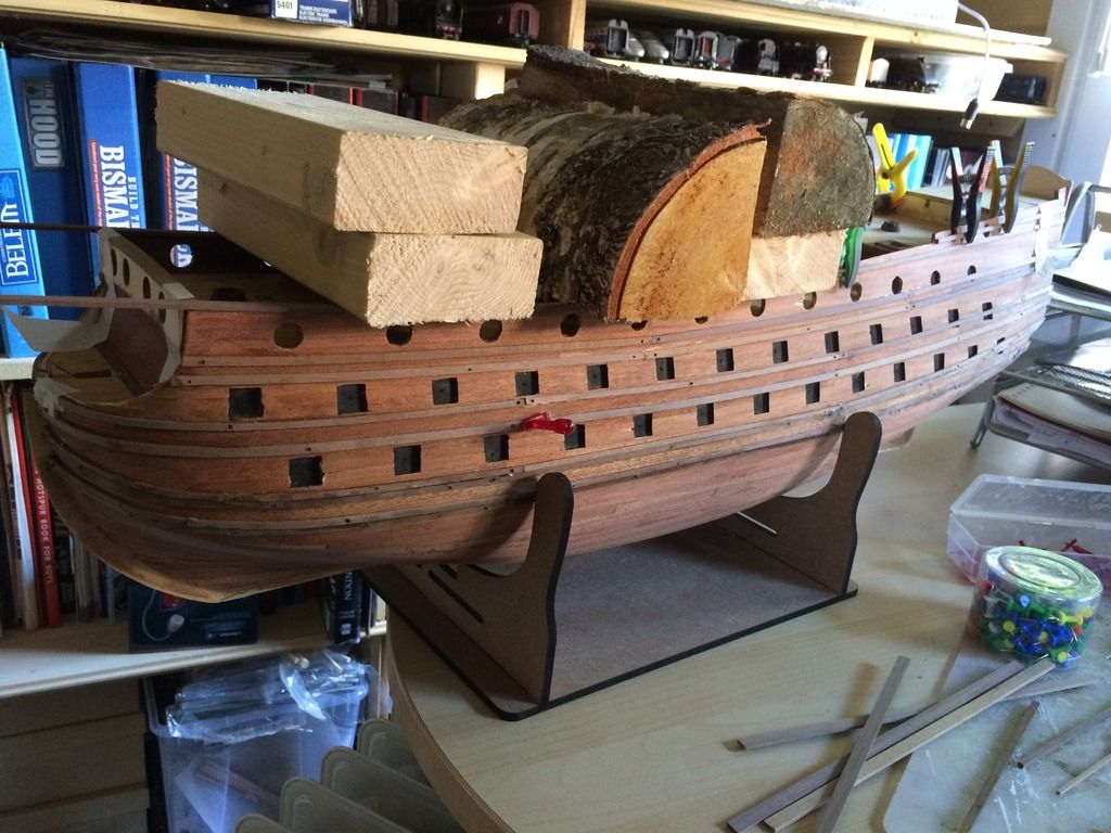

Postby booth » Mon Sep 26, 2016 3:27 pm
I am now back from France with the latest batch of issues. As my Mustang and Citroen are up to date I am concentrating on L’Ambitieux.
I am working on the hull first with the second final strips of décor wood. My preference is to use PVA instead of contact glue. I pin as much as I can and the final pieces are held in place by masking tape.

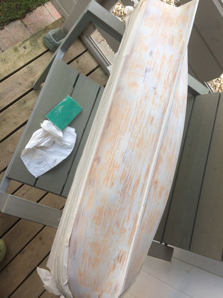

Finished and now needs sanding
Hull is now sanded smooth enough for the moment. I will need to do a lot more work on the lower hull later when I paint it white. I wanted to compare wood dyes to pick one that I prefer.

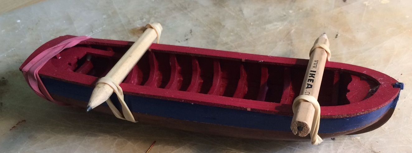

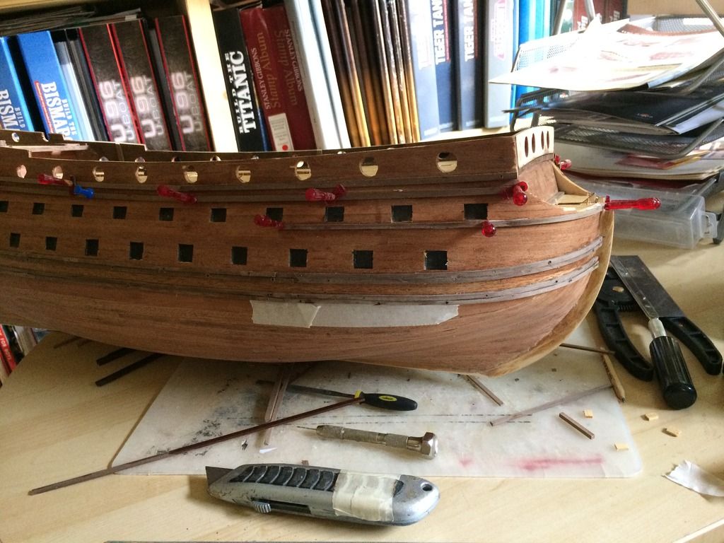

This time it’s the raised strakes around the Hull. The Walnut pieces were new to me and made a pleasant change from simply staining the same type of wood.
The instructions were to use instant glue but it didn’t take me long to realise that it was disaster for me to do it that way. Superglue everywhere and no chance to move pieces into position.
Very reluctantly I used PVA. Not an ideal choice as I needed to drill holes in the strips to clamp them into position. That’s ok on the lower ones as I they will be painted black but not so good on the upper ones which will remain as they are. I am now looking for a walnut filler to fill the holes.

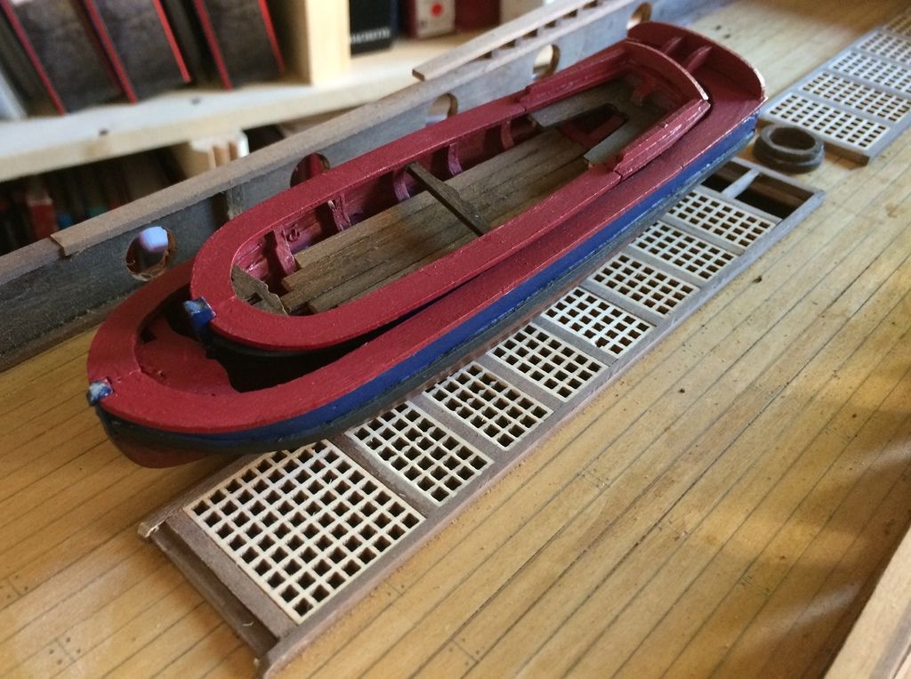

A few more bits for the launches and a new use for Ikea pencils.

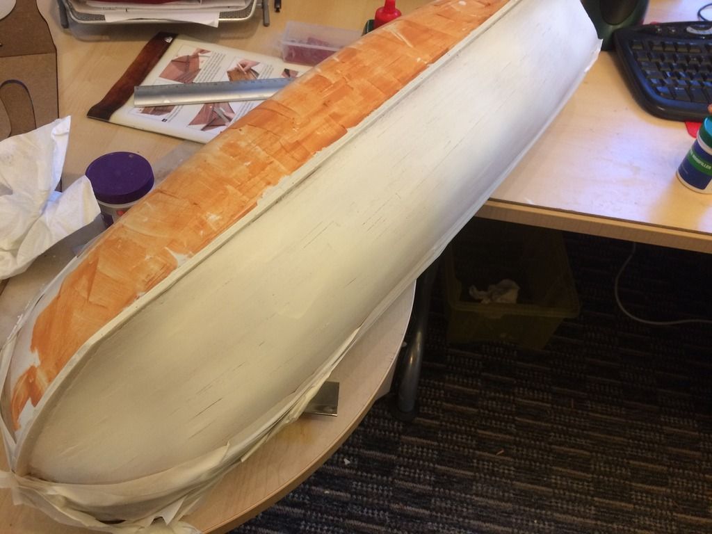

I have been busy again on the Hull. I want to paint the Hull white and so I had to do that ahead of the instructions as I didn’t want to damage the delicate railings which are the next on the list.
The first coat of white undercoat showed lots of cracks that I missed in my sanding. Several filling, sanding and coats of paint later I got to that ‘it’s not perfect but I am happy with that’ moment.
