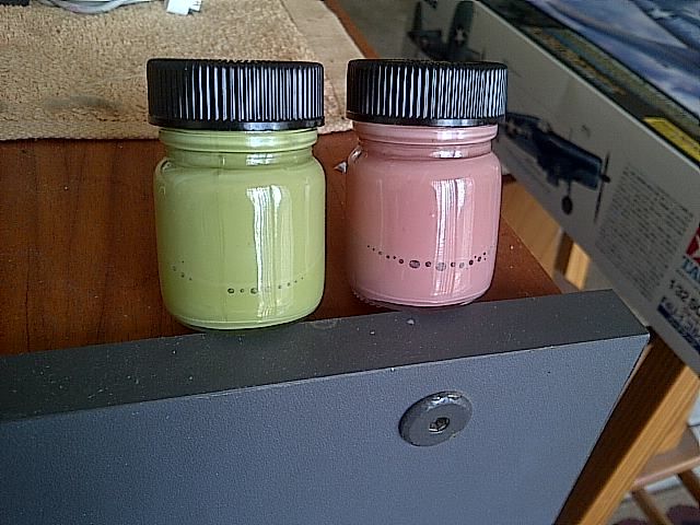

The first thing I noticed was that there are two lots of paint mixes to be made up namely cockpit interior green/zinc chromate colour and a rather strange (or so I thought) pinkish colour. Once again thanks to Morrigan for her great clarification and pics of this rather odd colour. The cockpit colour Tamiya calls out for seemed incorrect to me as it is a blue green mix so after a little research decided on a zinc chromate mix of my own. The Salmon pink mix was pretty much as per instructions.
Here are my two mixes even though the camera flash seems to change them quite a bit they look pretty good to me and also bearing in mind the parts will be shaded and washes added so final colour will be different
and to see how they looked out of the bottle I sprayed some into the fuselage interior

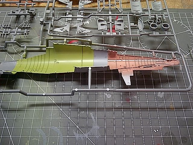

I have managed to get a fair amount of work done on this gem of a kit- Tamiya well done on this kit!!!!
first up was to paint all the sub assemblies and give them a wash to bring out the detail
