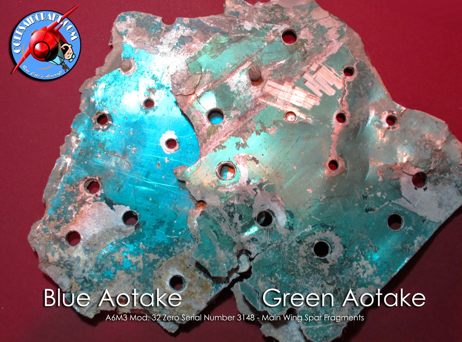

Both colours are technically correct. neither are wrong. Here are Aotake samples from a Zero. A6M3 Model 32 Zero, serial number 3148, built by Mitsubishi Heavy Industries in September 1942. Thanks to Coles Aircraft.com for the images
Looking at the images and the paints I would be very tempted to put a gloss clear coat over both the Vallejo and Lifecolour.
The Vallejo as it is a semi transparent paint does need a high shine metallic undersurface to produce the shine effect, However, the Lifecolour is a spray and go. I would recommend both to be in Japanese model makers paint boxes.

They were painted just the same as the standard IJN aircraft. The picture above shows a well worn paint job
