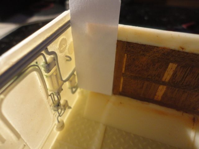

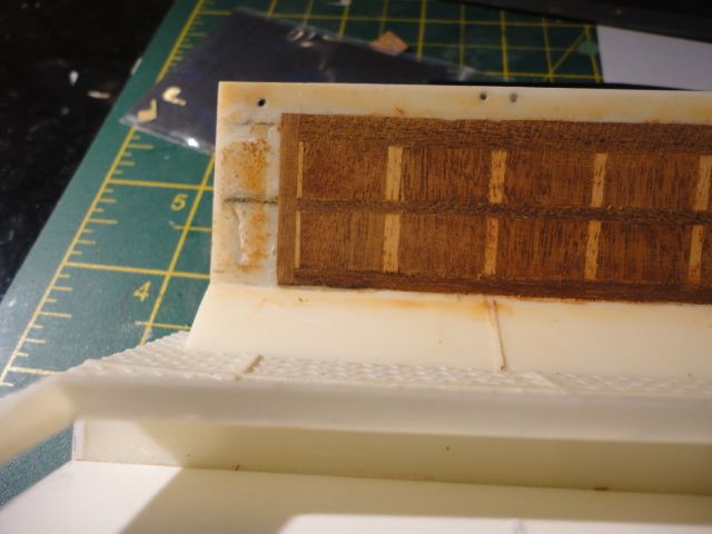

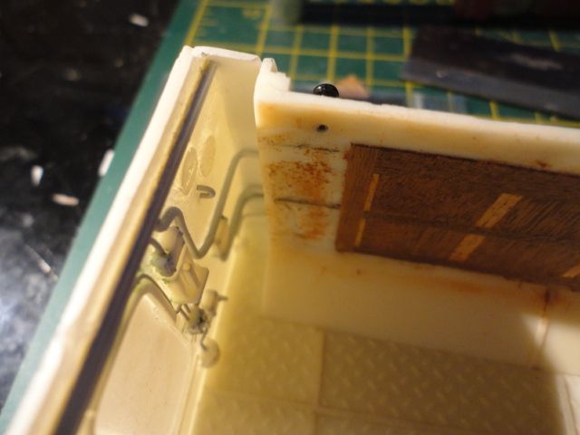

Postby Mustang » Sat Oct 03, 2015 6:00 pm
How the back wall looked before I attacked it.
Wood cladding and storage units
I'm awaiting some bits to finish these.
How it looks with the torpedoed added.
The torpedo hanging up is temporarily in place with some brass wire, just so I can judge the height before I look at making some more bits.

Postby Mustang » Tue Oct 06, 2015 7:21 pm
Cheers guys for looking in and thanks for the K's
So yesterday I had time to watch Das Boot from start to finish, and study the torpedo room and the out come is.
I need to redo the bulkhead wall :angry-banghead: and redo the side wall area :angry-banghead:
So I've removed the wood from the end of the wall area as this was a metal area with what looks like a hatch should be.
Now I can't do this part until I've redone the bulkhead as the wall is meant to go all the way to this and not have a little elcove area.
I'll add a piece of plasticard for the wall. But at the moment I've just placed a piece of paper in place.
