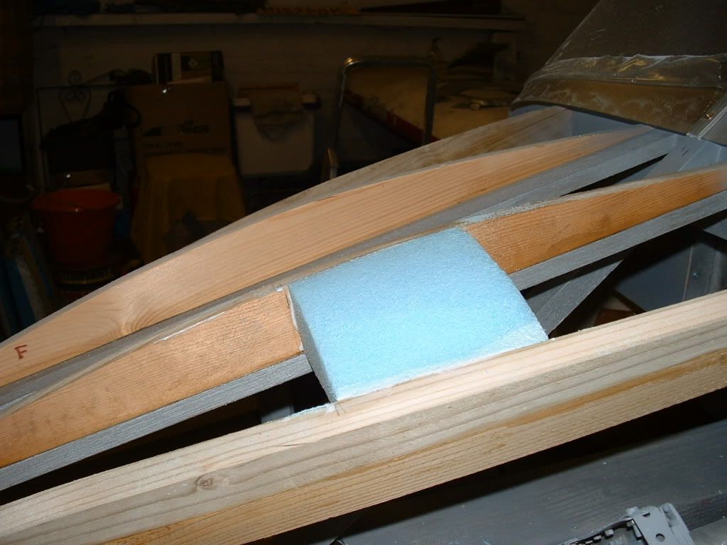

There has been lot done since the last photographs as you can see here,the front windscreen has been added plus today I made up the overhead cockpit screen as well,from my experiences with forming plastic sheet these past few days I taught myself a lot,this acrylic sheet has a mind all of its own and just as you tighten up that last screw..crack as a split appears,the only solution is to drill a small hole at th end of the crack to stop it spreading,I learned later that by applying a gentle heat it softens the sheet making drilling and screwing easier,the sides where it wraps around were daunting at first until I hit on a brainwave,why not use my model heat gun to gently apply heat locally and with a large block of wood just pressed the material overlapping it into shape,it worked !this is quite common it seems if you look at any selection of light aircraft,they all seem to have some stop holes in them as well,so I have realism at least.
The screen looks untidy at the moment because I have left the protective film in place to save scratches and paint overspray.
As you can see the rear module ( I call it the Tardis because once you are inside working on it that is what it feels like ) has come on leaps and bounds,the starboard side was made up from scrap alloy sheet or other aircraft bits reshaped,the port side was all there so effectively served as a pattern,I used up over 500 rivets getting that right and just kept bending and hammering until it was right,a good job my workshop is in the countryside away from any neighbours,the whole lot was flashed over with Halfords excellent grey zinc based primer,its expensive stuff but does the job admirably,as I want this to last for posterity everything is solid and sound in construction,the original fuselage was flimsy and made from fibreglass which shattered when it turned over on take off,everything is the same except my replacement fuselage is good old timber and plenty of it,I have enough offcuts for modelling in the future of some very nice wood,nothing ever gets wasted.
The original instrument panel has been mated to my replica structure,I have some donated instruments coming next week plus other parts that will be used or modified,there is even a spare wheel coming as well,people in aviation are very kind especially when they can see a vintage aircraft being re-incarnated,this is 1960's technology and even the map pocket has a period aviation chart in it from my collection,to me the detail bits make it interesting,I plan on having a fully lit instrument panel with VHF radio receiver hidden away to make it realistic,I also have plans to make a wooden Porsche engine with an electric motor inside to drive a hand carved pusher propeller,inside that pod is a myriad of structure behind the bulkhead,everything was worked out as a triangle for absolute strength and longevity,the oiginal powerplant seized solid and was scrapped,I have various authentic fittings from it including the air cooled radiator which as been mounted on the port side,I also have the original Porsche aero engine propshaft converter,a really heavy lump of hardware.
Once this lot is done thenI will gather together a selected gang of helpers to assist me removing the wings one day and turning the fuselage and centre section around in the workshop,then construction will start on the booms to add to the original tailplane,I need to make up two replica fins and have one rudder to use as a pattern,the elevators will be made from a cut down Piper Tomahawk set which I also have on standby,the shape is remarkably like the original elevators which were damaged,I have lots of other fittings awaiting assembly,some I have already clened up and repaired and are in waiting,so thats it until more work is done on this unique vintage aircraft,she is the only one in the world and needed saving,above all I have learned a lot about solving problems,everything has been done on a shoestring with basic hand tools and that has been the fun aspect to it,if I do not have it then it is made by hand after thinking it out beforehand.
The last picture shows the first of many high density foam blocks that will be shaped and inserted to get the contours right,once fitted and blended in they will be covered with aircraft fabric.
Barry.
