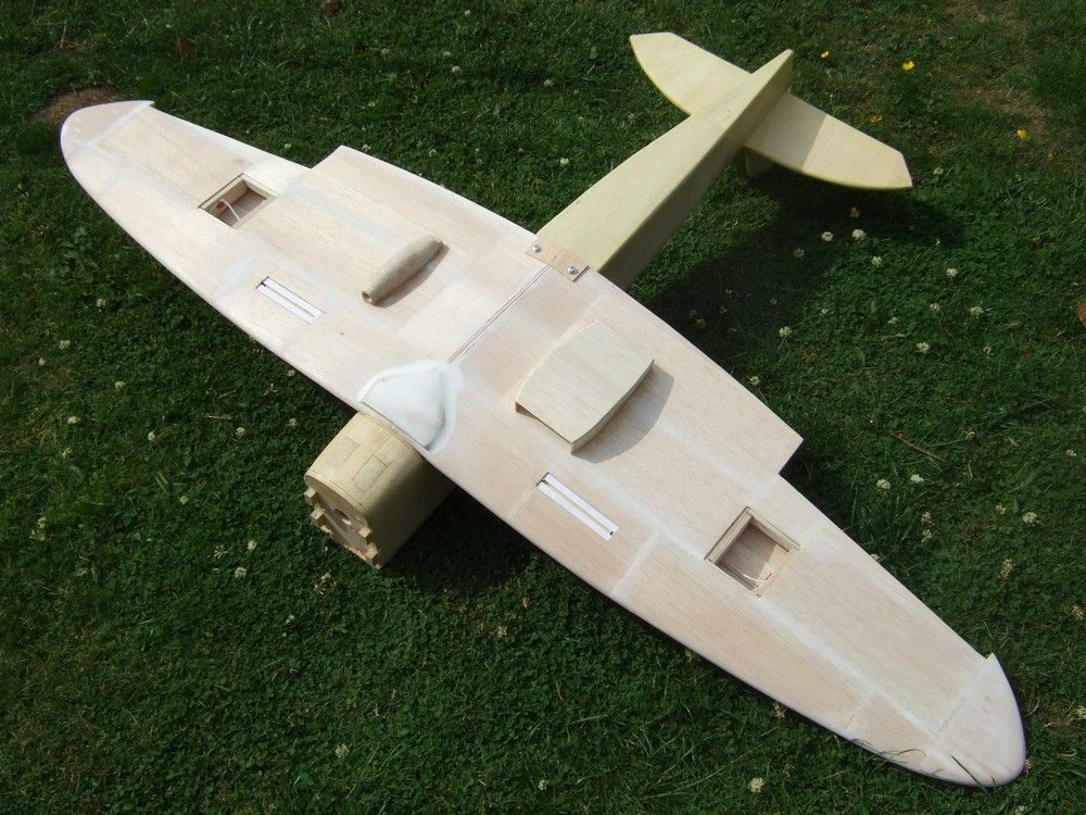

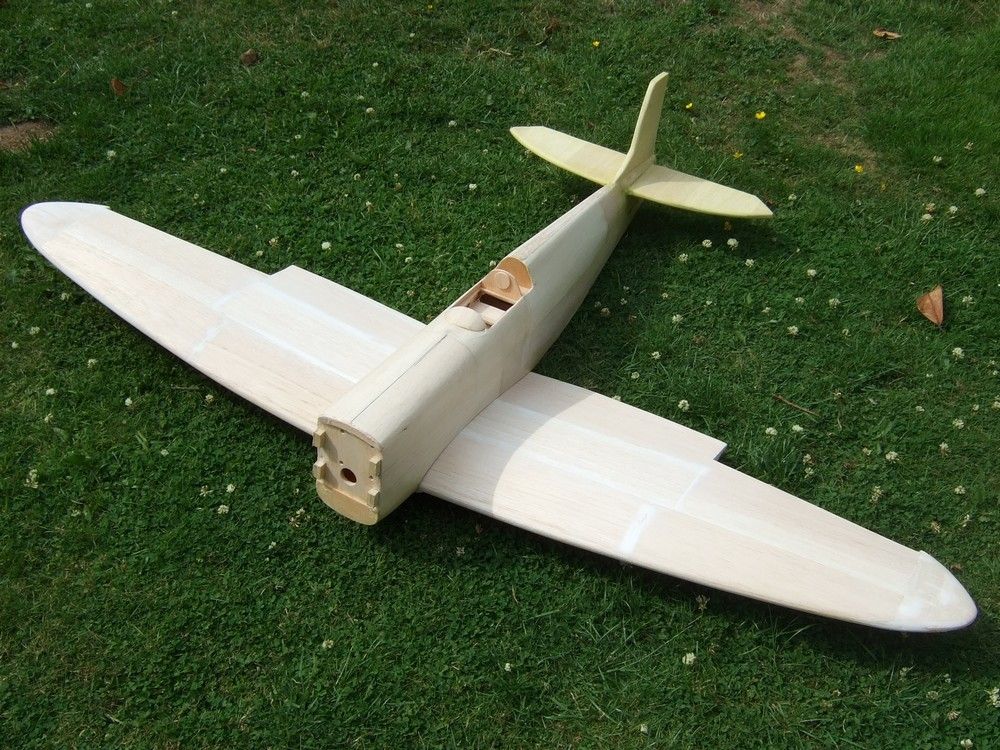

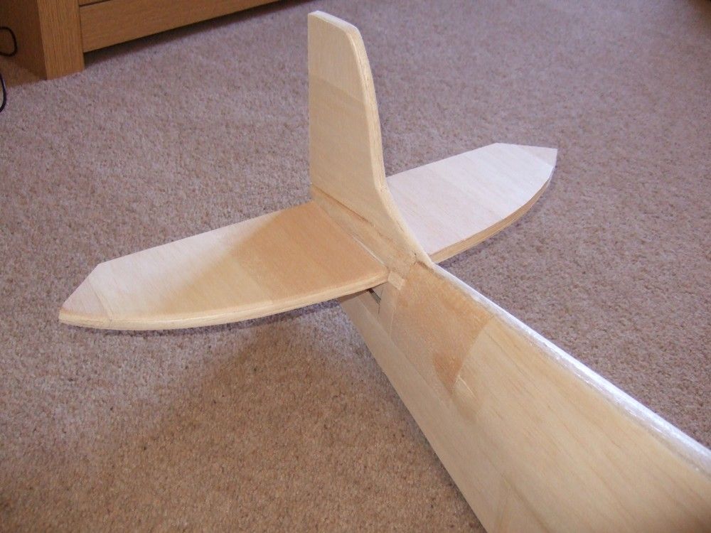

yeah, quite big really.

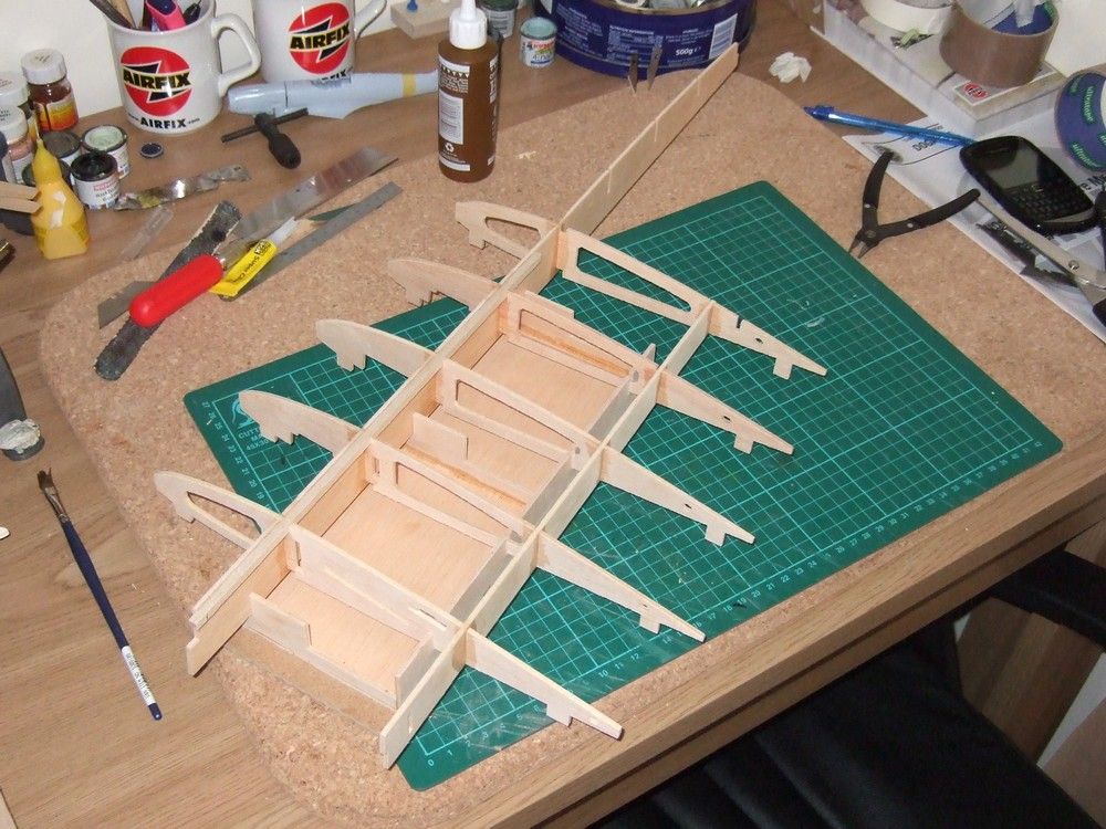

OK, here's the rest of the build so far....

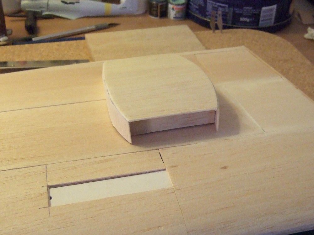

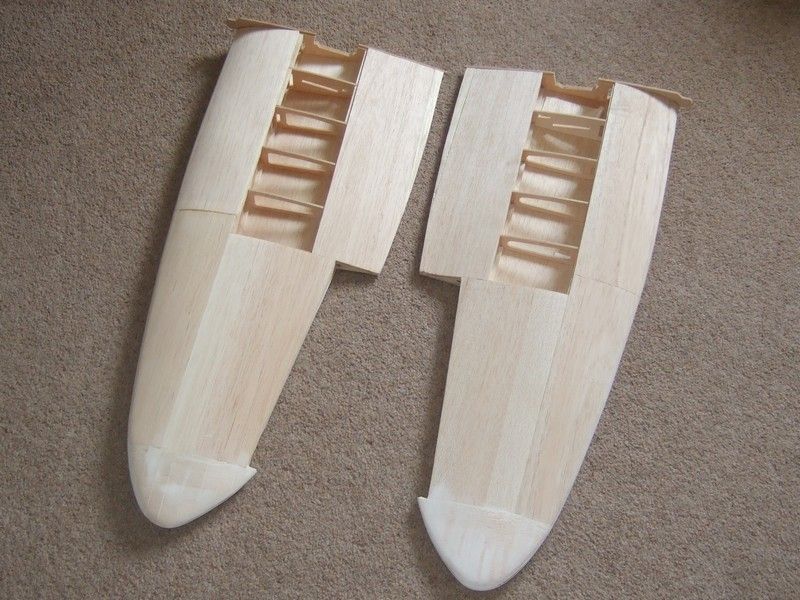

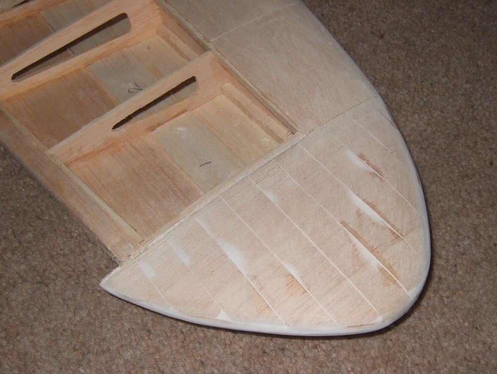

started putting the skin on the first wing half...

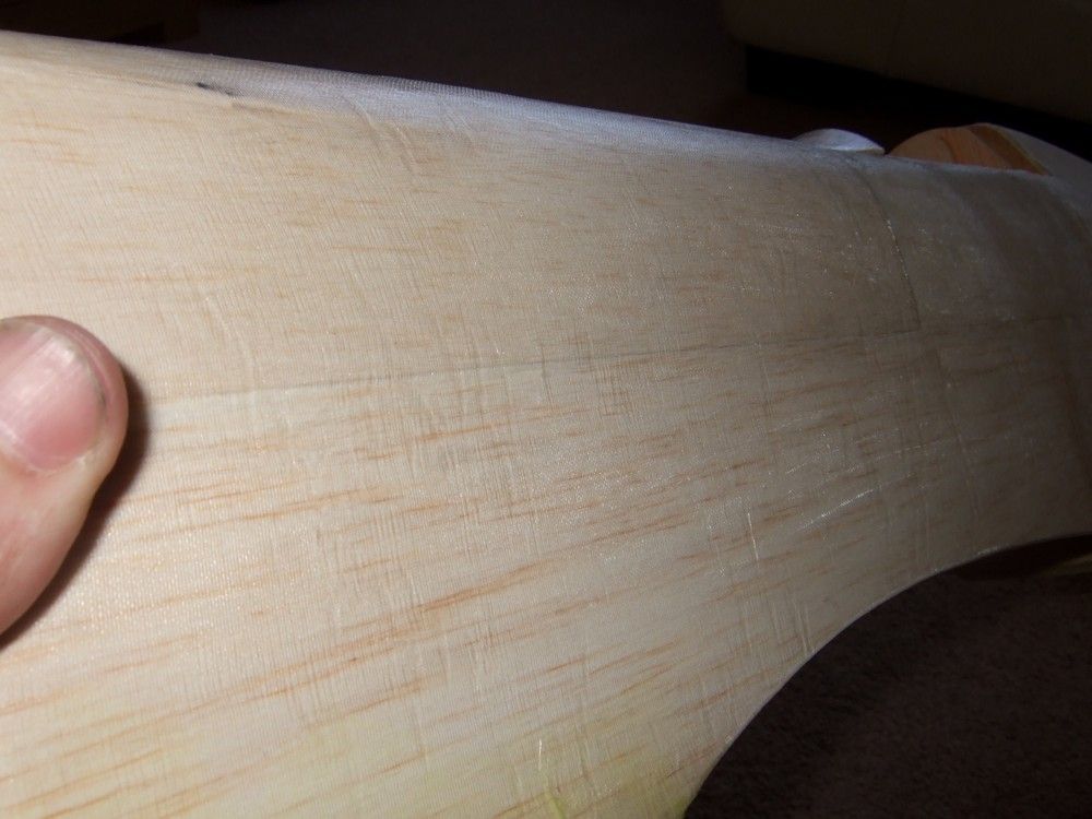

i decided NOT to use the heat-shrink finish provided with the model. im going to give it a light fiberglass coating that will allow me to paint it like a giant model. i think this will look better.
bought some of this and it seems to be working fine...

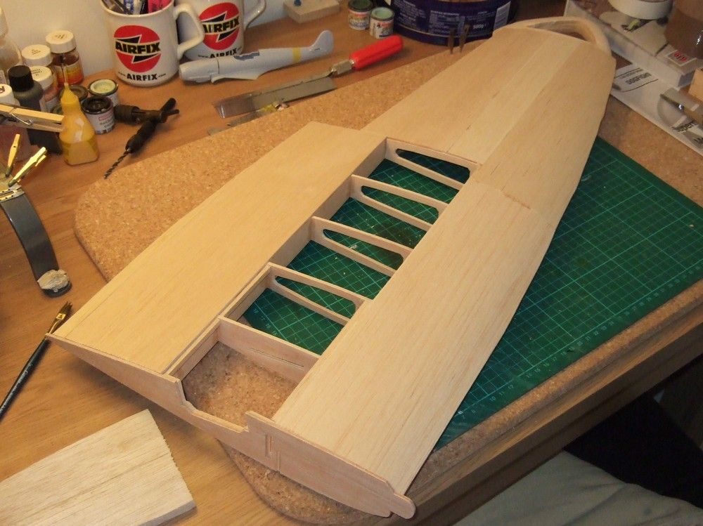

using the fiberglass coating means i have to skin it a bit different to the instructions, basically to cover up all the holes...

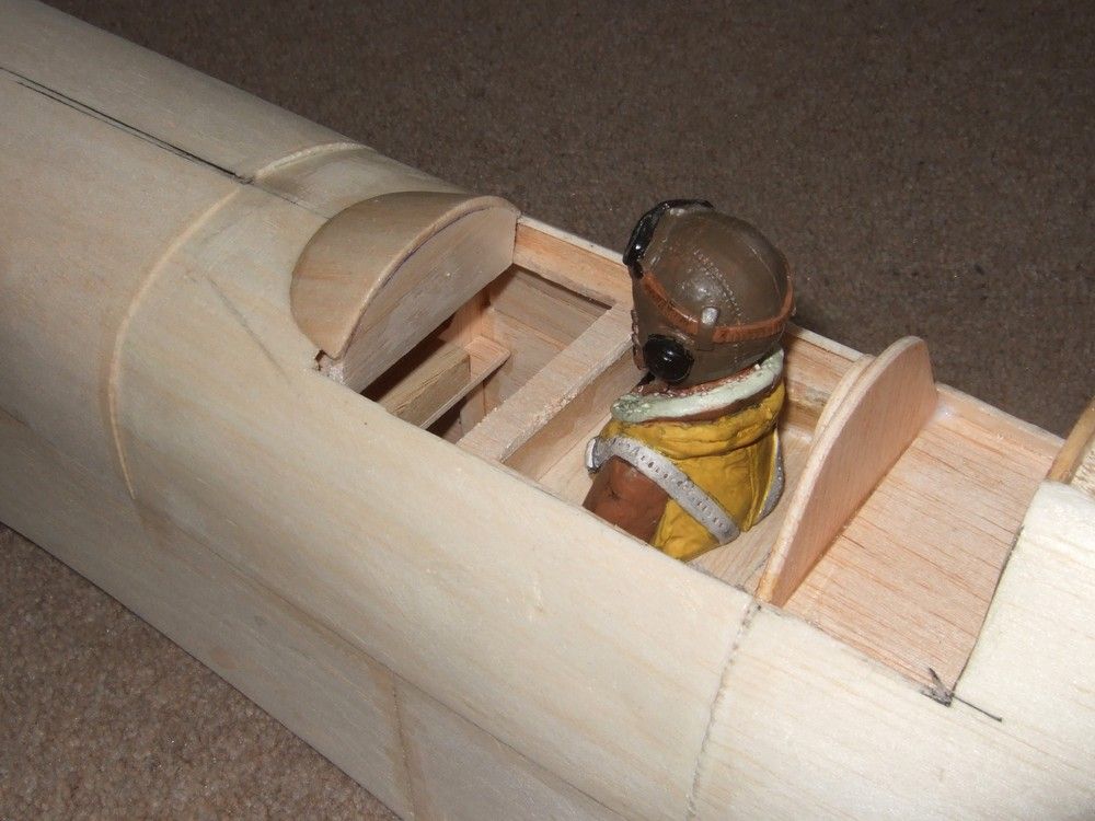

a bit more work on the cockpit...

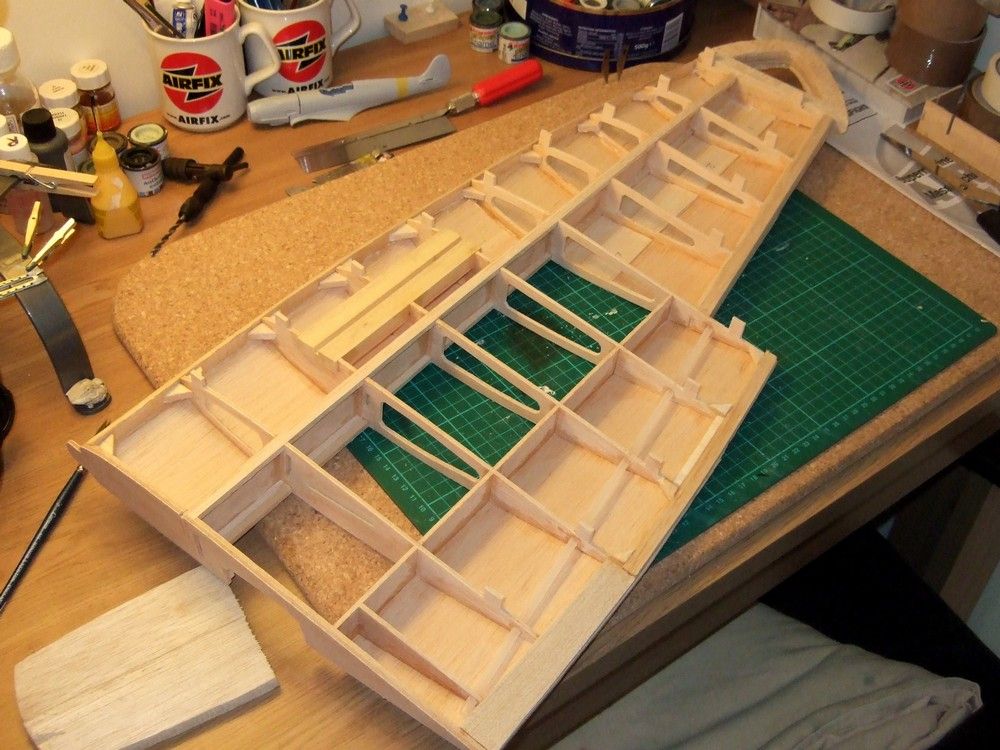

and starting the second wing half...

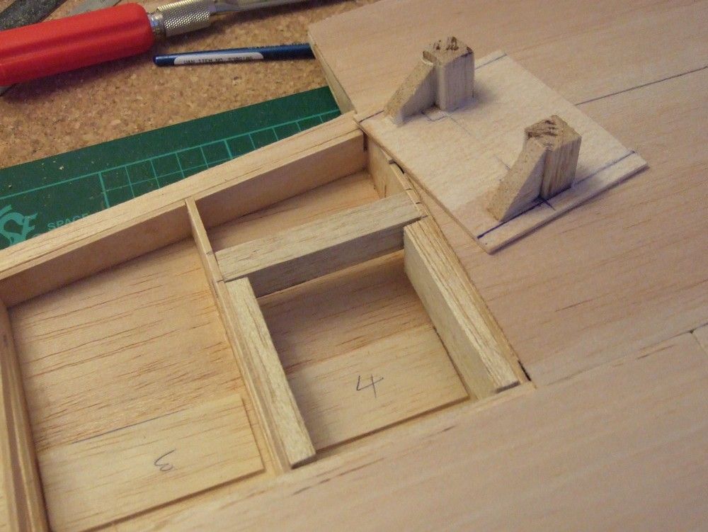

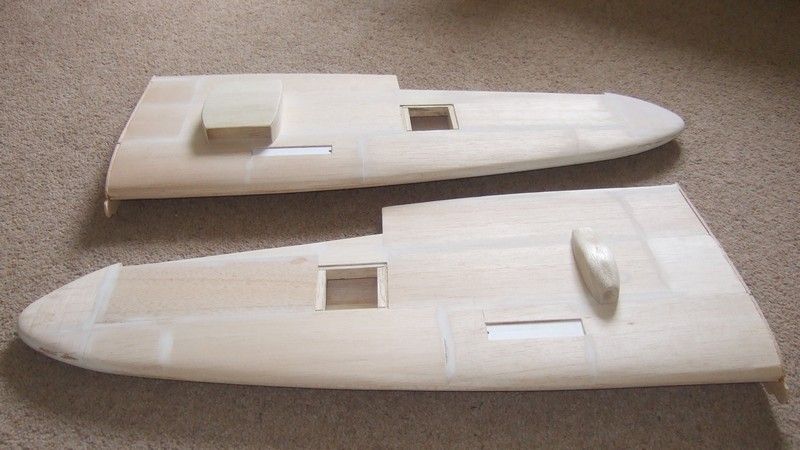

im also mounting the aileron servos in the wings so needed to make boxes for these...

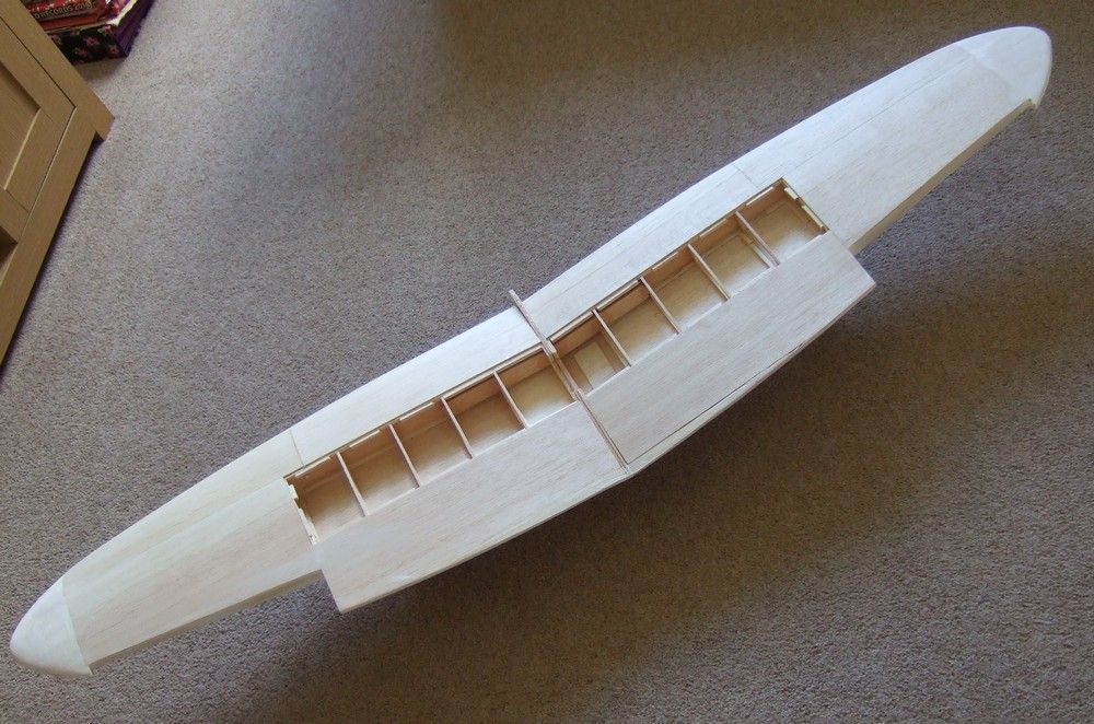

the two wing halves...
joined together...

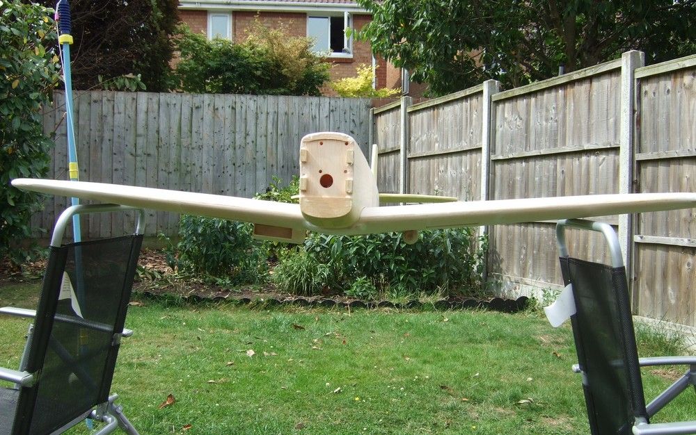

and this is where im at now. just put some matting on the wings and will be getting some primmer on them soon...
