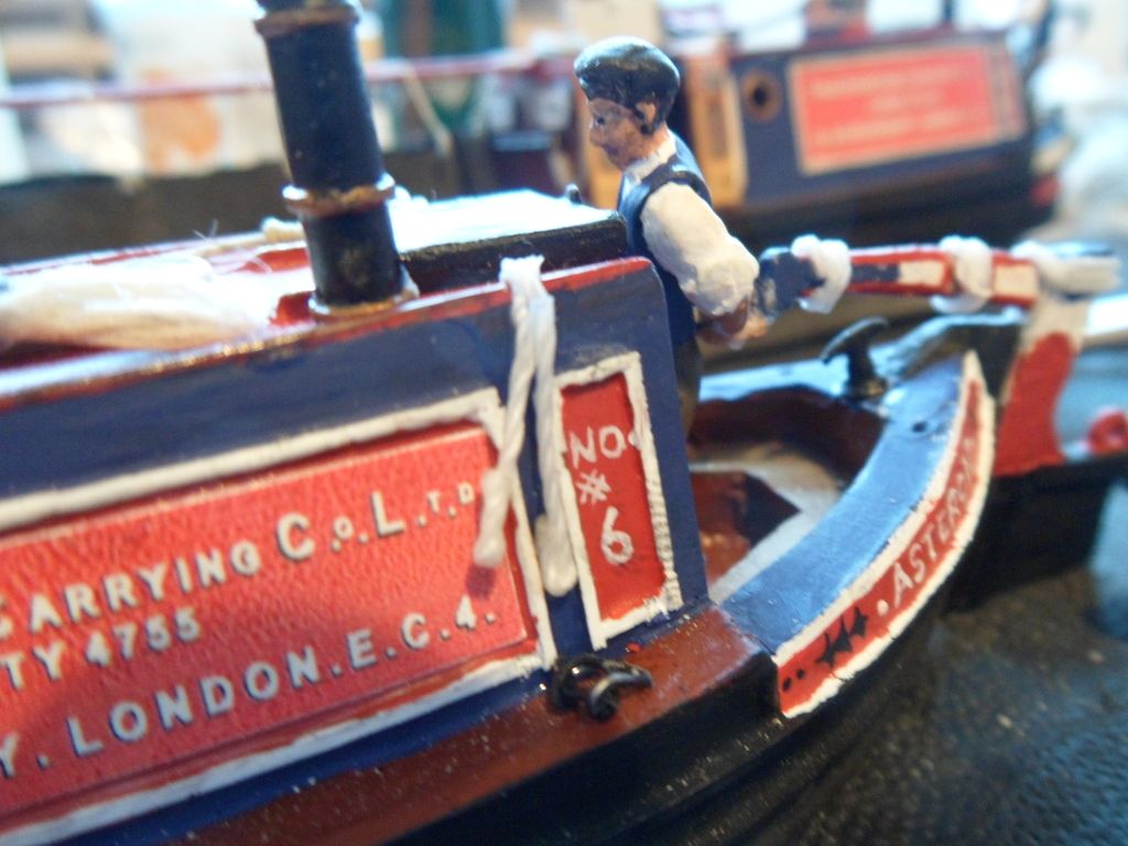

First, I got the masking tape again! And just like the company initials on the canvas, I cut into it the boats name, (In this case, 'COMET' in keeping with the tradition that the names of craft in a particular class resembled what the class name portrayed! e.g craft of the 'Town' class were named: Gloucester, Brighton, Bristol, Norwich ect.)
After I stuck the name to the cabin side (I know it's the open side but it's just to show how the name runs over the doors! :shifty: ),
I painted on the name in white paint, tidied it up a bit, and painted on the black shadowing, It looked rather like this! :| :mrgreen:
Whilst on the motor boats the name was almost always on the engine room doors, on the butty boats they were often painted on either the bow or the stern gunnels! However they were more often than not on the stern gunnels so again that is where I've chosen to paint mine. Due to the sale and size this painting has to be, I'm unable to do the shadowing and make it look really nice! :cry: so instead I've had to just paint it simply and FREEHAND!! :evil: :o (It wasn't too bad though considering! :oops: ) but it ended up looking like this, :think: It'll do...
I've also added the company name and details to the stern cabins as I've mentioned it so much! I tried using some home printed transfer paper but this failed miserably :evil: and after a strongly worded letter to the company that produced it (with not much success I must add... :x :snooty: ), I decided to do things much more simply and print the design out on card and glue it on! :handgestures-thumbupright: (I couldn't freehand paint it on as the letters and numbers were even smaller than that of the butty name! it would have been suicidal for me to try and paint that small! :( Still... At least it looks nice! :D )
As you may have seen from previous photos, I've also painted a little number in the middle of the little back panel on both boats (different numbers) It was common for companies with fleets of boats (large and small) or boatbuilders to mark their boats with a fleet number, or a number corresponding to the order they were built on the assembly line! I.e number '#' 1 was build first then #2, then #3 and so on! I've just chosen two random numbers for mine. It was common that a motor was built and then a butty was built to accompany it (in the days of motor boats) if it was ordered by the customer but boat pairs were often reshuffled or boats were built out of order so the numbers on the boats didn't necessarily match up. (unfortunately I don't have a photo of this stage! :( sorry.)
Finally for this little post, I'll whack up a photo or two of the painted figures that you'll no doubt have seen in many of the photos! Both hand painted of course! :) I had to move/break their arms and posture a little bit to get them into the right poses as they were originally farm labourers! one holding a broom and the other forking hay bails.

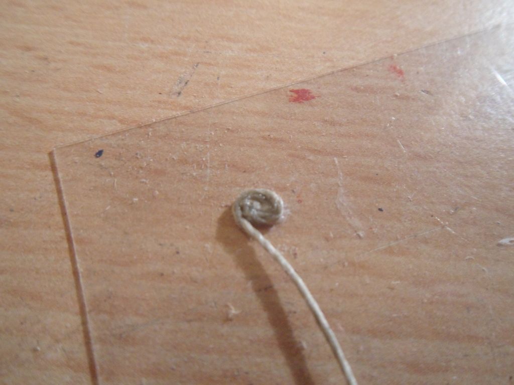

Right, next up I'll deal with all the rope work. To make the coils of rope (Known as 'Cheesing') I take the good old .8mm twine which is becoming a veteran to this build diary! and with a blob of superglue, stick it to a scrap piece of plastic.

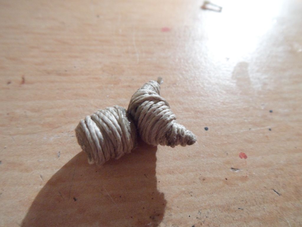

Then, by wrapping it round the blob of superglue (gluing as you go), you will build up a coil which will eventually look like this!

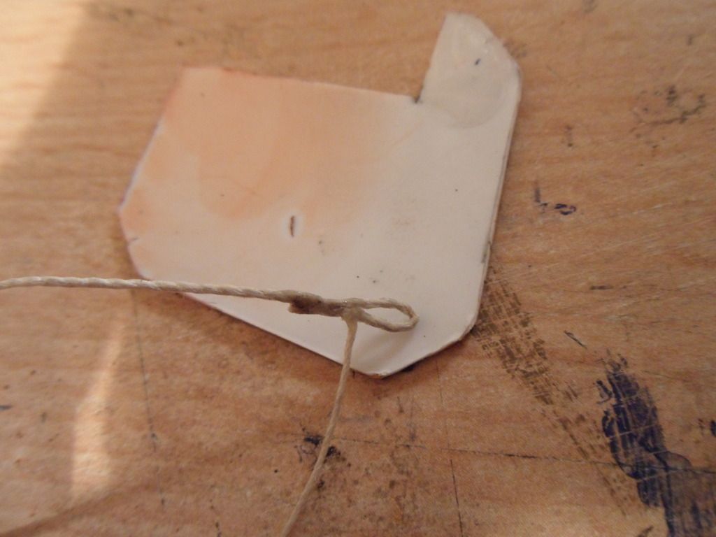

Now to make the loop at the end, I took the loose end and folded it back on itself and glued it together leaving a little loop in the middle just big enough to fit over the 'T'bar. (sorry about the photo! :oops: )

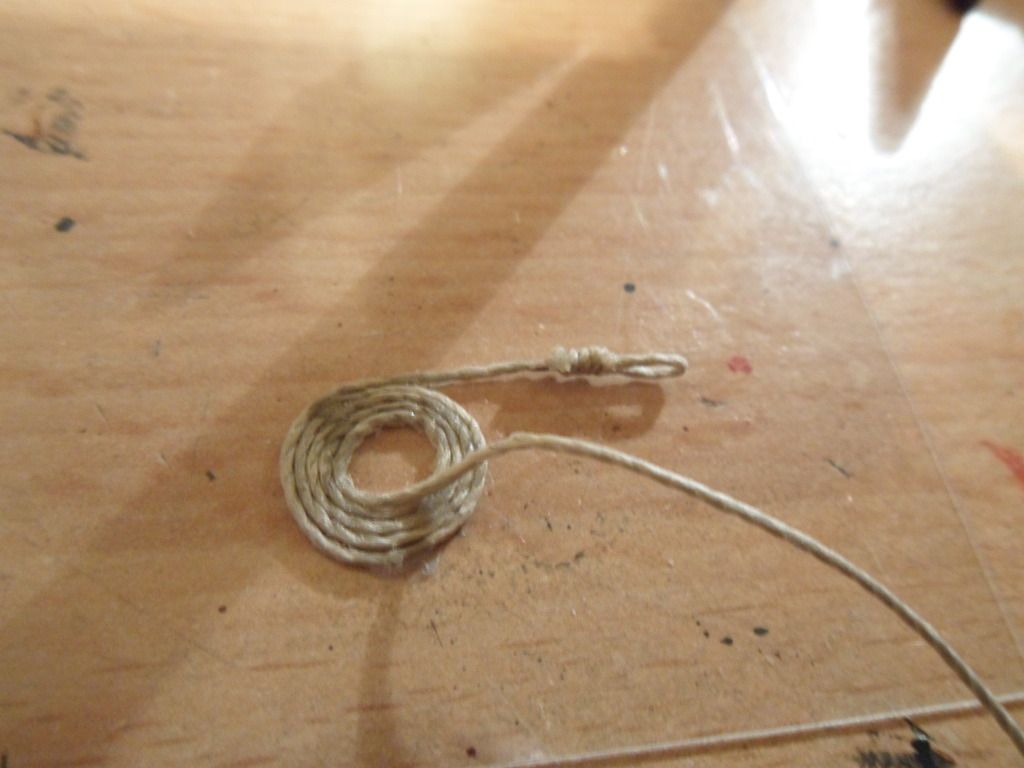

I then got some thinner twine (.5mm) and glued the end to the base of the loop,
By wrapping it round and round the 'splice' and gluing as you go, you'll end up with what looks like a hangmans noose! :?
Voila! :D the same technique was used for the connection of the center line to the ring traveler on the motor. This 'Cheese' was then glued onto the bow of the motor, (The butty used to only have a center line and a stern line so didn't have a 'cheese' on the bow I'll explain why in a bit.)

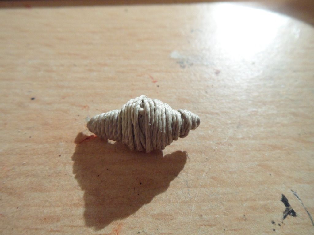

Ok, we've seen one rope fender, Now I'll show you the others! Made using the same technique as the little button fender, they started with a wire frame and then wrapped round with the .8mm twine. shaped and glued together, they formed an assembly that fits on the stern counter to protect the thin rudder from being hit by the butty during towing. (when the butty was attached using cross-straps, the button fender was hauled out of the way and onto the top of the other to get the pair closer to reduce drag so this was removed after shooting these photos and will be replaced when they are finally glued in place.)
Here you can also see the two black bollards on the stern of the Motor boat used for mooring up, 'breasting up' (both boats tied side by side), and towing the butty. (Just saves me posting this later! ;) )
To complete the fenders and for authenticity, I took some 1mm chain and cut it to lengths and glued one end to the stern counter and the other to either end of the fender(s),
