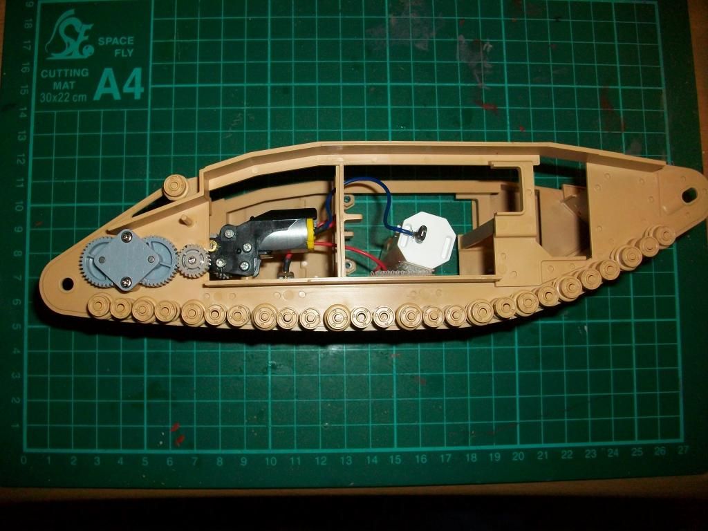

Now the right hand side of the Tank.
An overview of the wheel set up prior to installation
Al the wheels in place. Just don't forget top left hand wheel above the motor. Not that I did of course ;)

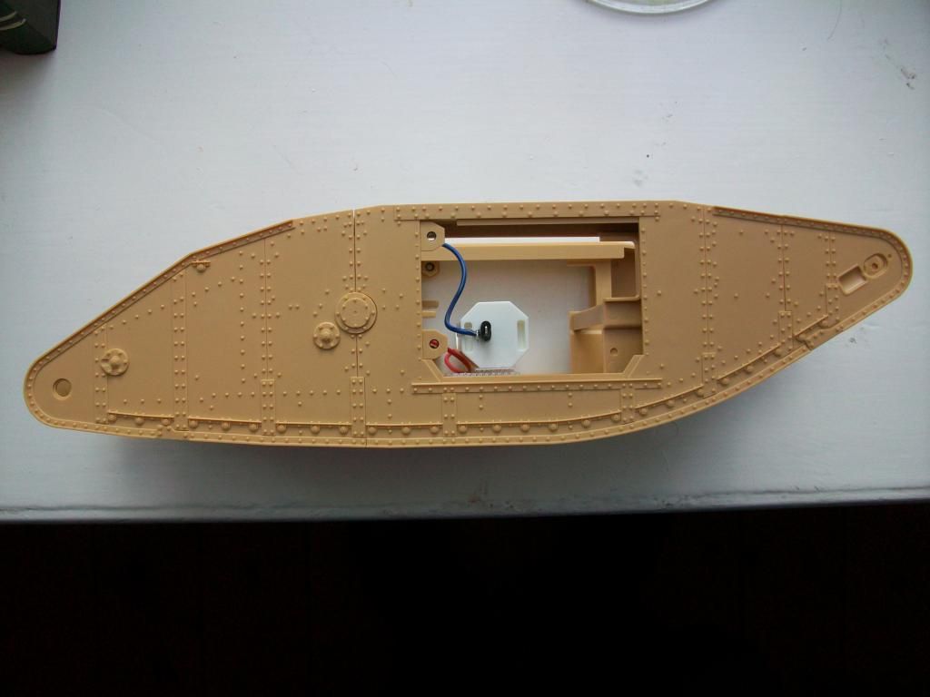

Now some bigger pieces of plastic. The main side armour piece. Last chance to ensure everything is smooth and fitted and running on the the wheels.As once this piece goes on theres no going back:
The rear armour plate going on:
The final front piece. I know theres a gap on the rear but I closed that up somewhat and the tolerance is a lot better:

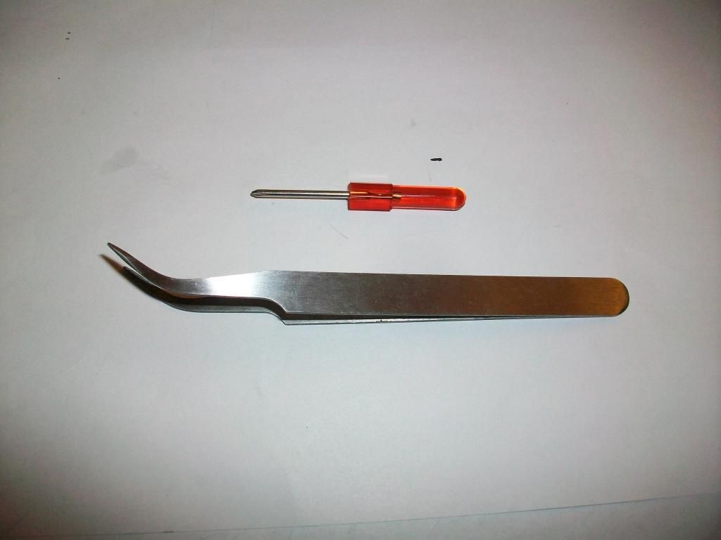

Using the supplied tiny screw driver and the tweezers from my Zero tool box I set to work:

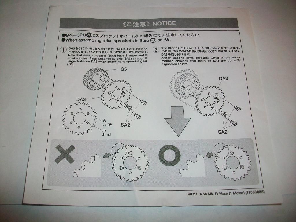

Im glad this sheet was included the important information that the teeth of the metal gears need to be perfectly aligned for correct track operation:

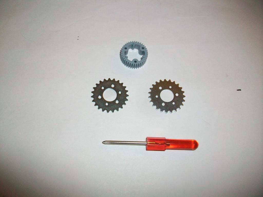

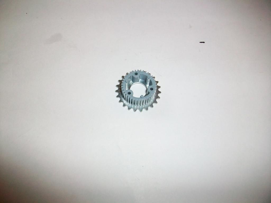

The following parts :

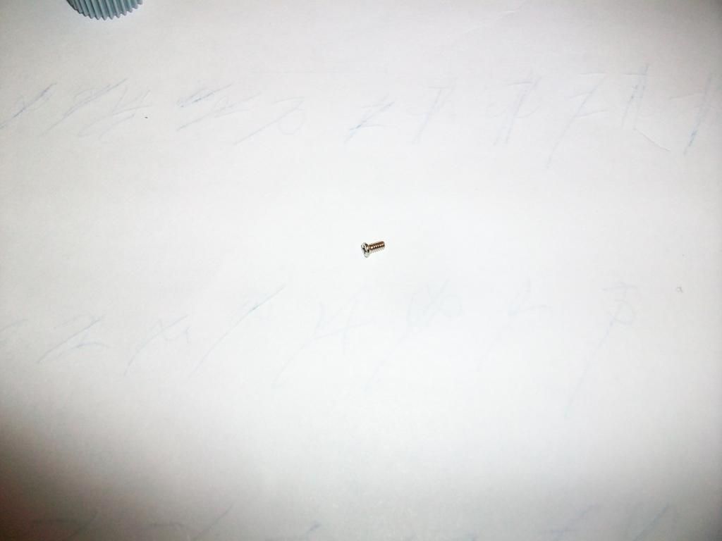

Are held together with these: MICRO SCREWS. And they are MICRO. Cue magnifying glass at very close proximity:

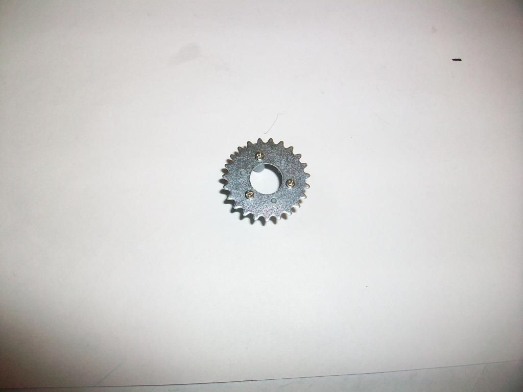

be careful when putting the plastic cog on the metal part, As the holes on the metal part are ever so slighty smaller than the screw holes. took me a while to figure that out :whistle:

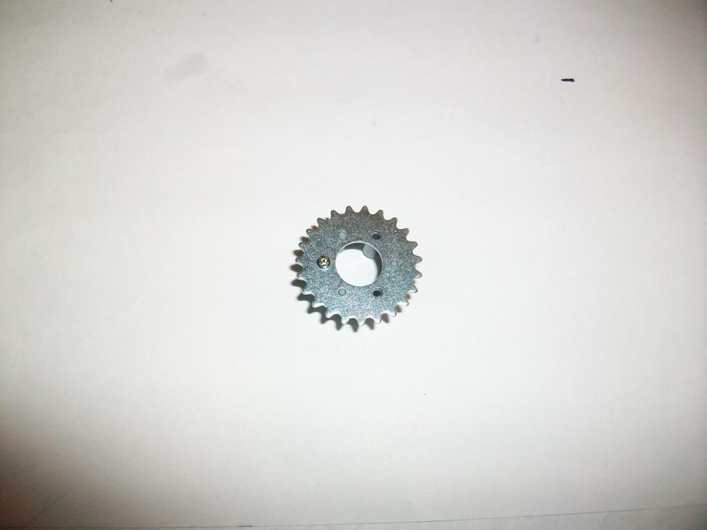

Three screws each side. First one in. You can see the aforementioned hole diameter difference in this picture:
And repeat the screw application on both sides:

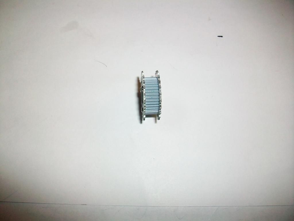

Then you end up with this sub assembly. I used a Allen Key to ensure correct alignment of the the teeth:

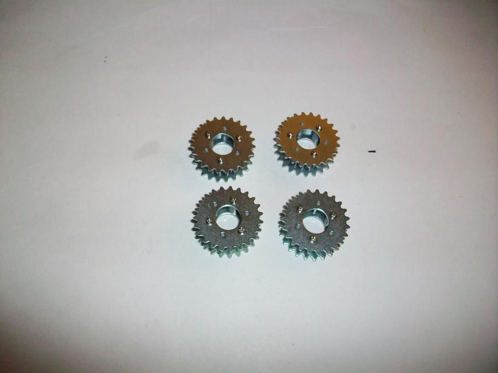

Then repeat all the process till you have Four completed drive gears. it was a long night
