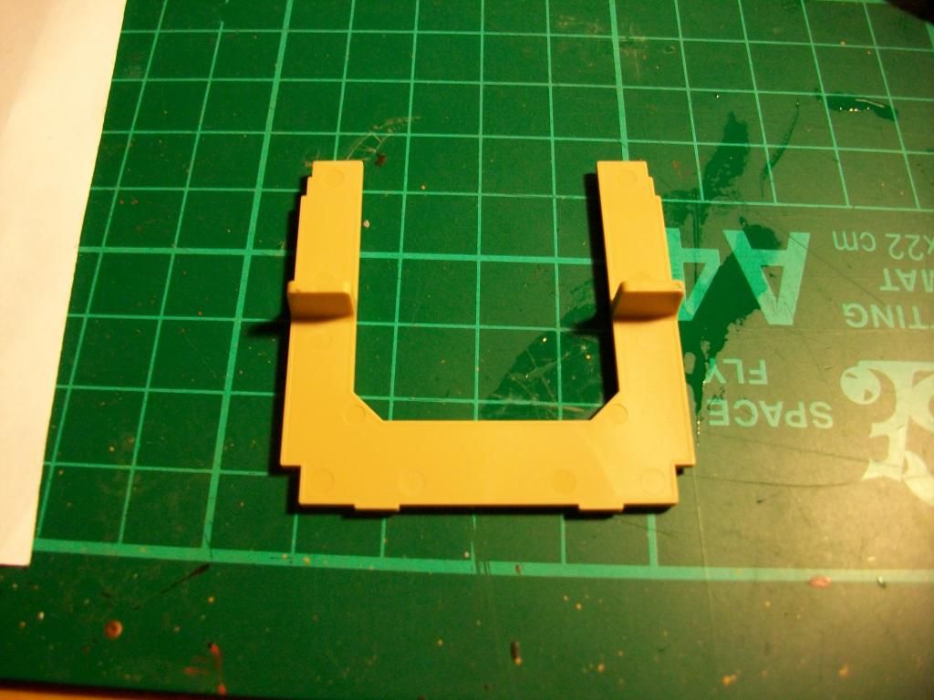

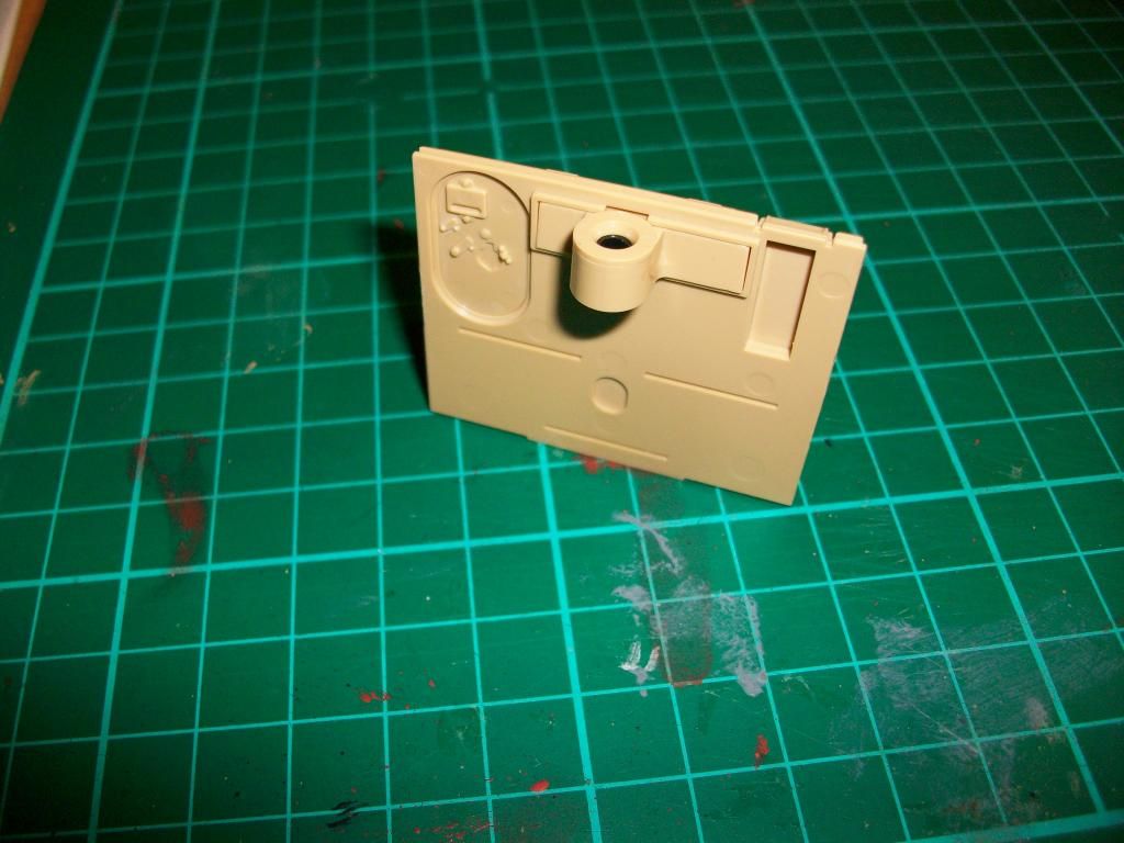

Just a quick upload today.I assume this part is bulkhead. The instructions allow for the door open or door shut, I went for door shut.
Im so glad I spent time knocking the warp out of the piece (see previous posts) given me a nice straight level top.

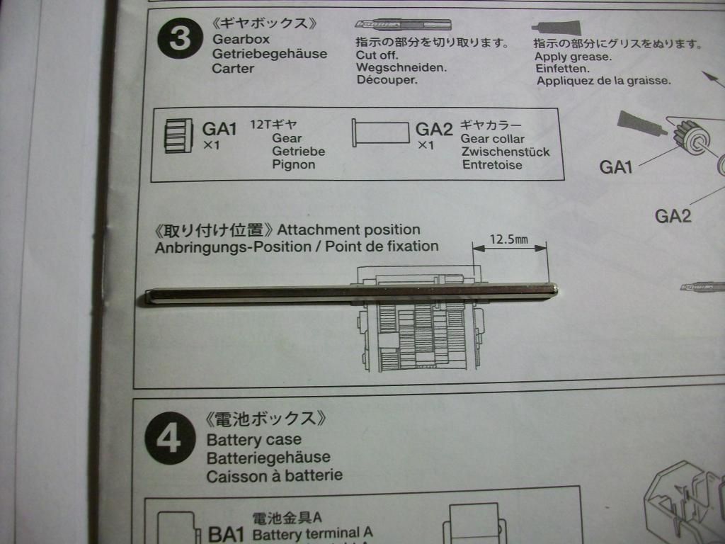

Back to the build. With regards to the instructions, I've noted there is a lot of 1:1 drawings . Such as The main drive shaft allignment. Details in next photo's

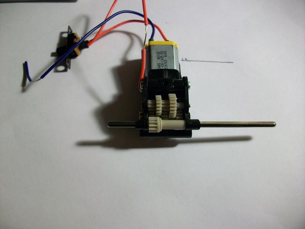

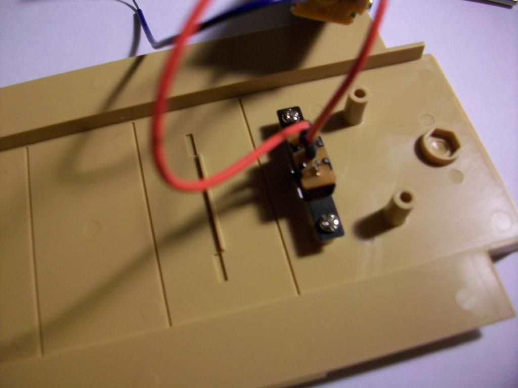

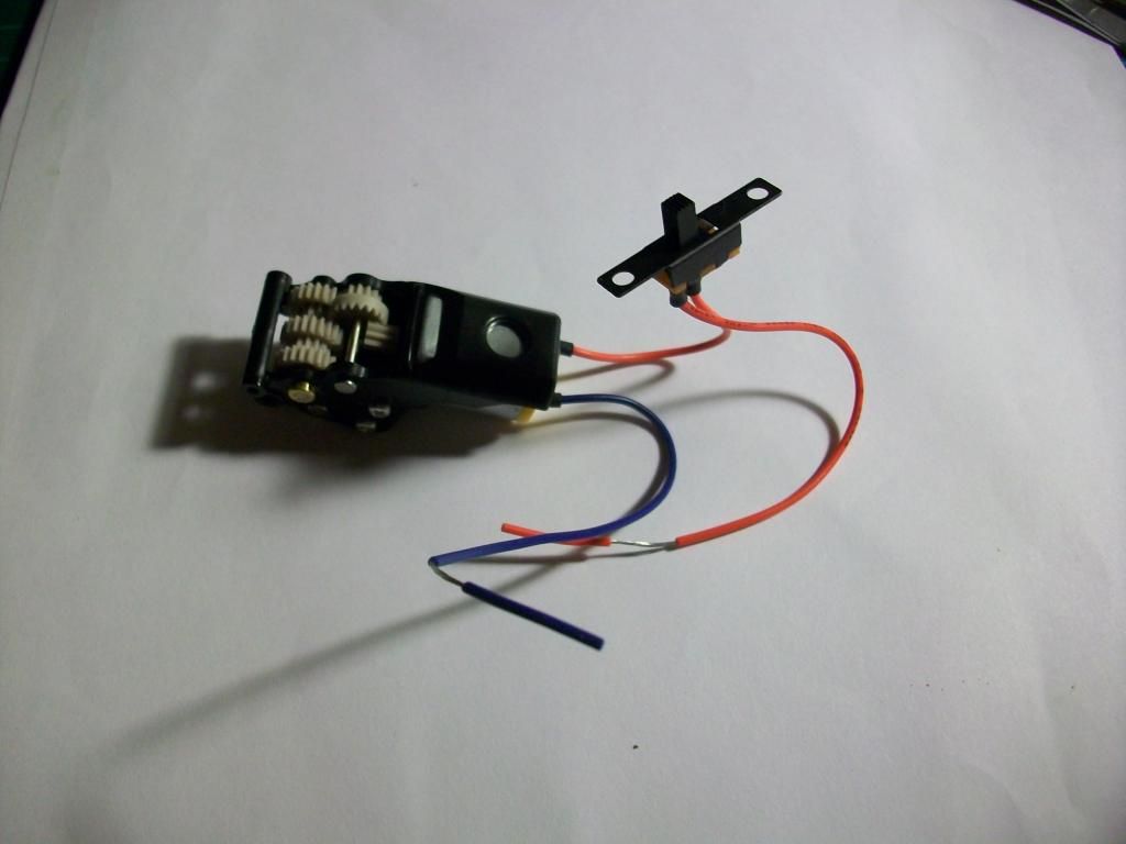

Now the power plant and the on/off switch
To be fitted to the base of the Tank. As you can see there is room for two motors to be fitted. The left hand set of holes are for the switch. The right hand holes are for the motor. Only one mounting hole is used for the motor, the top right hand one for this build.

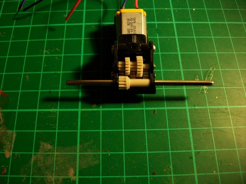

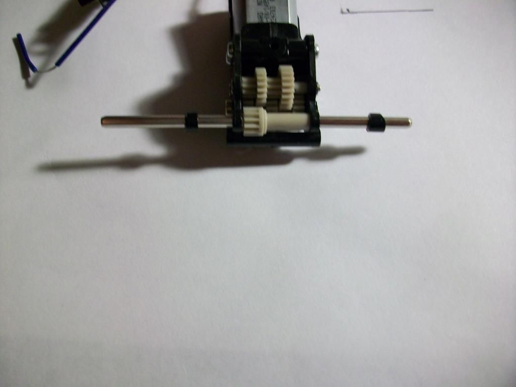

The main axle and gear and spacer and a piece of rubber tubing used to make 'stoppers' from.
Another diagram that is 1:1 scale to assist the exact position of the axle which has to be off-set
Axle and gear & spacer in position
Next some tiny 2mm long pieces of the rubber tubing pushed onto the axle. This was really fiddly.
Fully pushed home on the axle

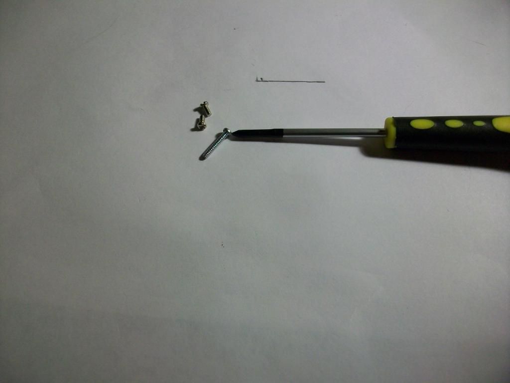

Now for some tiny tiny screws. The large one for mounting the motor the two smaller ones for the switch.
Switch in the mounted position. You can just make out a spare spade connector for additional motor to be fitted.

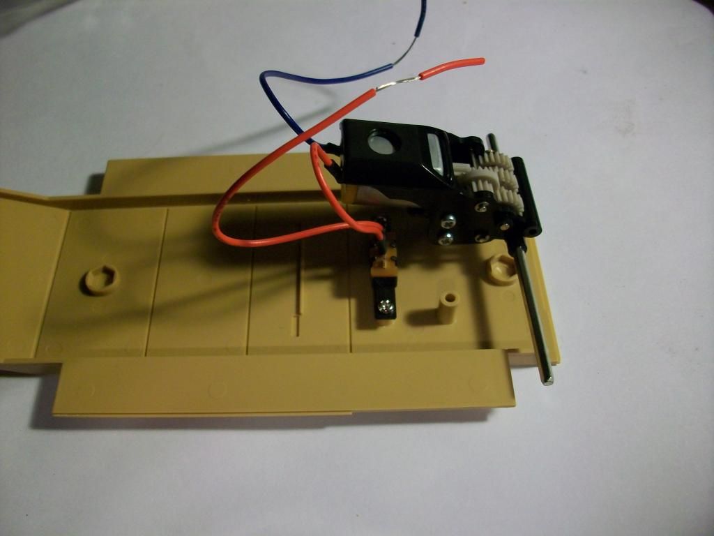

The motor next . A hint. I ran the mounting screw down the motor mounting pole first to form the thread (self-tapping screw) and then offered up the whole assembly for final fitting. Making sure the engine is true and straight
Now this is my next query :think: Next stage calls for the following parts to be attached and fitted all at the same time
Now if you look carefully at the side tank piece in the bottom left hand corner there is a semi circle with a hole just above it . This is to allow a screw to be inserted to the side of the motor securing it in place. I was thinking screwing the part to the motor first then the upright piece to be glued to the tank then the main side piece (hope that made sense!) as I only have two hands.
Any ideas

Ok yes I don't see why you can't put the SA4 screw in first to hold the motor then do the rest. :think:
Posts: 5667
Location: UK
Karma: 367
Re: Its here...WW1 British Tank Mk.IV Male.
Postby Mustang » Sun Jan 04, 2015 8:08 pm
Does C4 not clip into D33, or add some glue to hold it in place.
Posts: 5667
Location: UK
Karma: 367
Postby chill » Sun Jan 04, 2015 8:55 pm
No it doesn't clip in. I was thinking about using the screw and going from there
Posts: 7723
Karma: 161
Postby Mustang » Sun Jan 04, 2015 8:59 pm
Well you can only try screwing it in, if not just have to under the screw. No harm in trying.
Posts: 5667
Location: UK
Karma: 367
Postby chill » Sun Jan 04, 2015 9:11 pm
Indeed less permanent than glue
It's more over for alignment purposes
