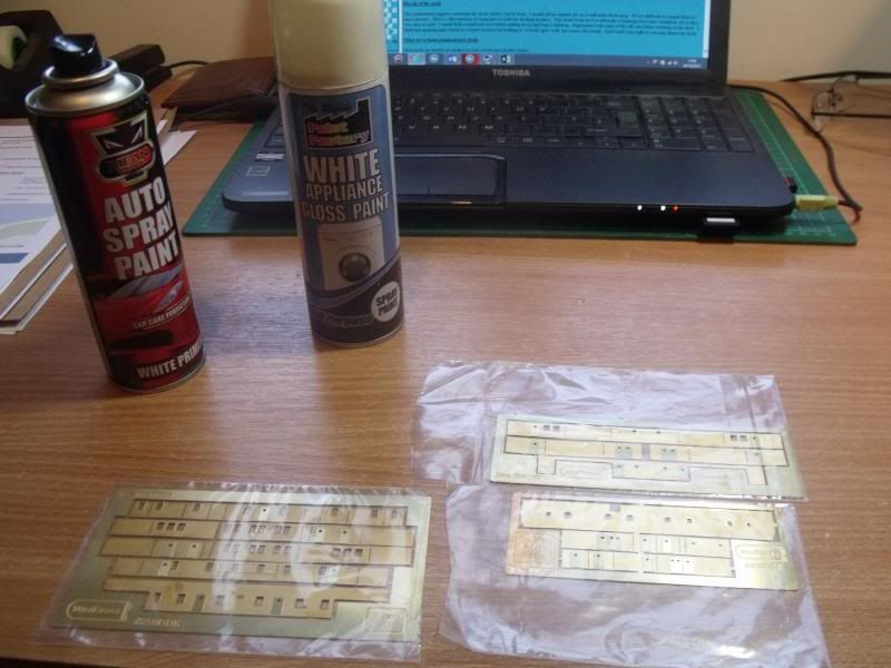

Been studying Mark's site, and Eric's build, and have a quick question about painting the photo etched parts. Never worked with these before (only airfix, graupner and balsa kits in the past), so it's an interesting learning curve.
My thoughts of how they should be painted (looking at all the recommendations), but please jump in with comments/suggestions/slap on the wrists...
1. Rub down lightly with fine wet n' dry (presume dry - not wet)?
2. Then clean with a lint free cloth - white spirit ok or something else?
3. Spray lightly with a white primer. (All frets supported on matchsticks)
4. Once dried, spray with White Appliance Gloss.
5. Hand paint the C Deck lower wells in brown.
Thanks all!

Postby Eric » Fri Oct 04, 2013 6:26 pm
That's basically it Graham, I would add to use white spirits to clean off residue before painting. I only sand the reverse side of the brass so the glue gets a good grip. I use Tamiya grey fine undercoat spray.
The white gloss I use is car spray paint. I hand painted the brown colour with Humbrol.
Another tip. Pre bend the brass into the correct shape and fill the small gaps at the bends before painting. I use thick SG, but you can use solder too.
Looking forward to seeing your progress!
